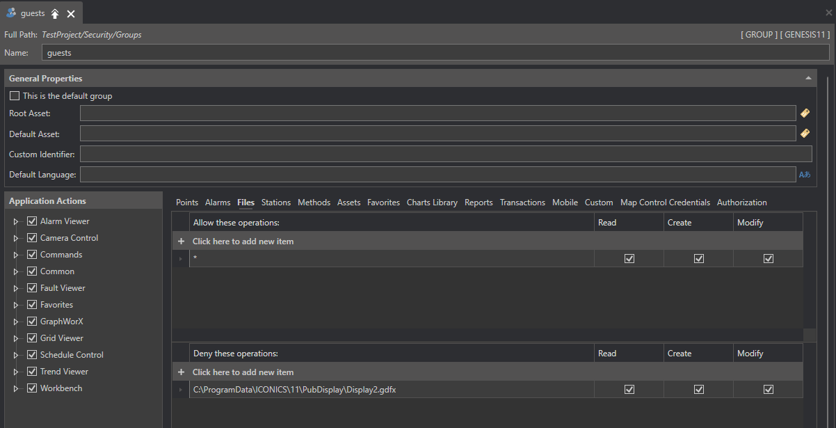

In GENESIS, there are multiple ways to customize user rights. One of them is limiting access to certain GraphWorX displays by specifying them in the Files tab of the Security settings. In the example screenshot below, access to the file Display2.gdfx is denied for all members of the guests group:
We then display this screen in a GraphWorX Viewer control after the user clicks a menu bar button. Because the button itself is not restricted by access rights, every user can click it, and a message about insufficient permissions can be shown in the control instead of the display. Since the behavior differs between Desktop GraphWorX clients and Web (HTML5) clients, both versions are explained below.

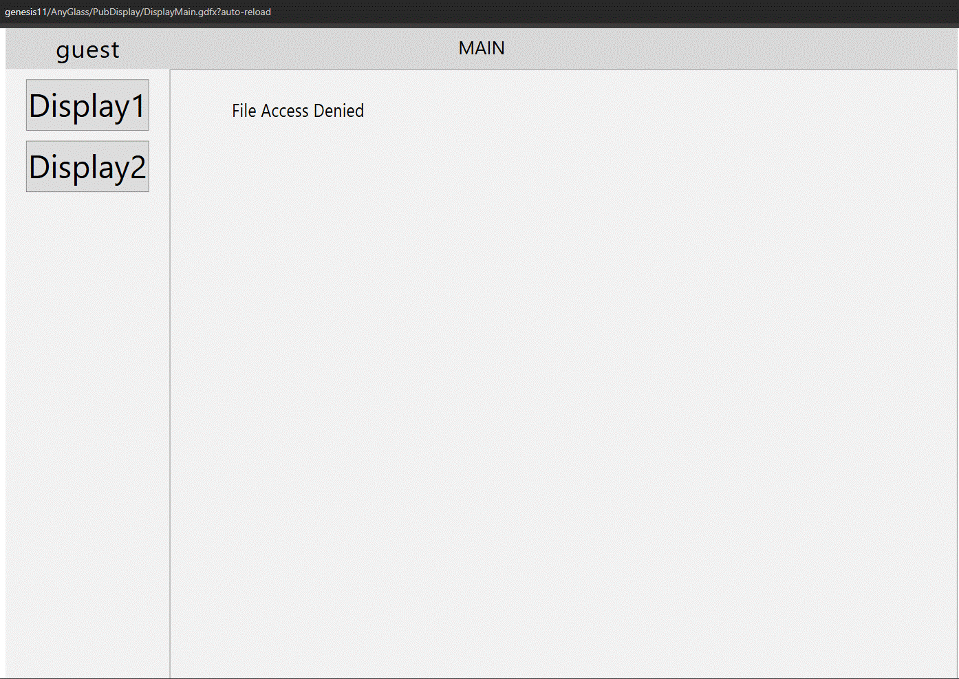

For users accessing the visualization via web browsers, the Access Denied display is different:
This one can also be modified - the default file path is: C:\Program Files\ICONICS\GENESIS64\Services\AnyGlass\wwwroot\projects\file-access-denied.gdfx

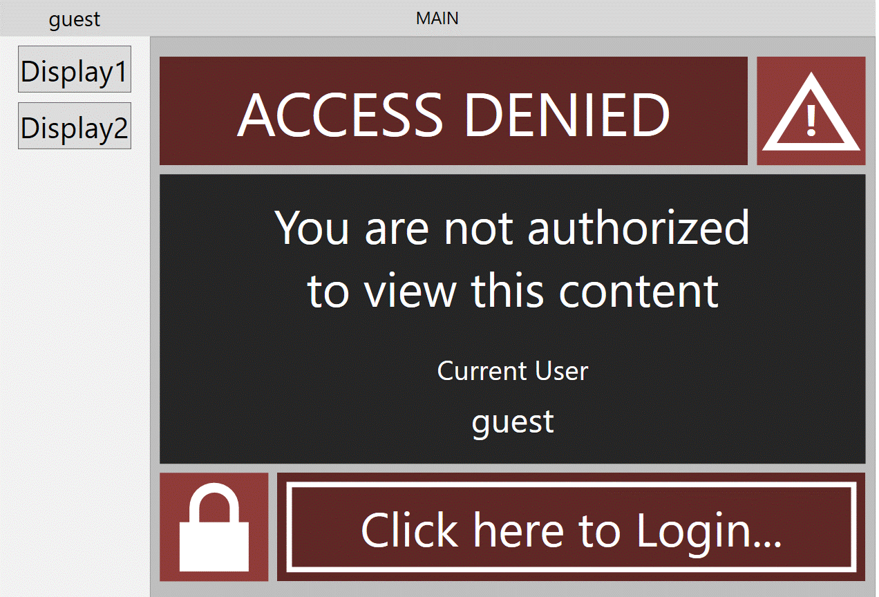

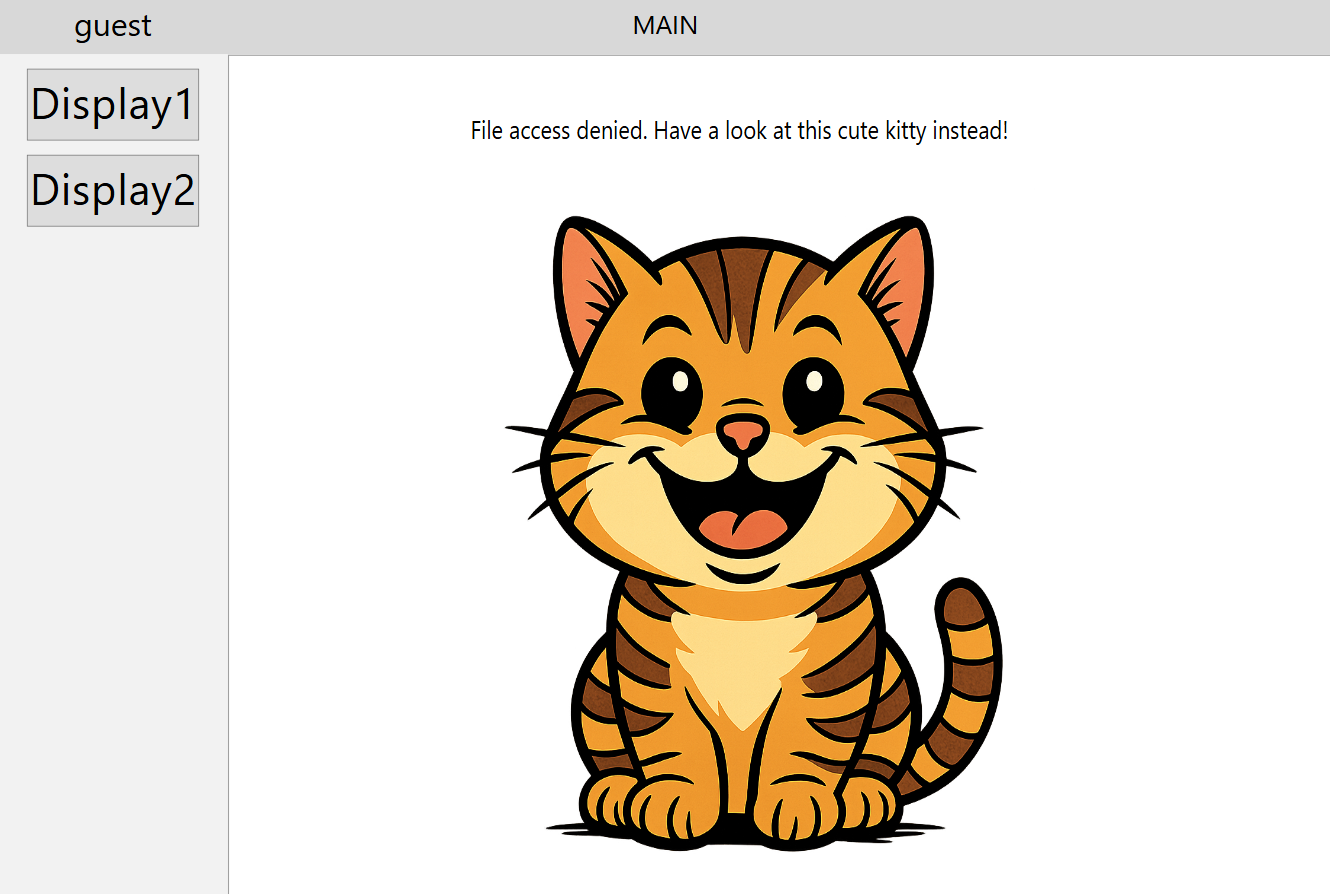

Administrator rights may be required to modify files in the wwwroot/projects folder. If you have trouble customizing your file-access-denied.gdfx display, first copy it to another directory, make your changes there, and then paste the customized version back into wwwroot/projects as an Administrator.
Your custom version will be displayed for all web clients:
