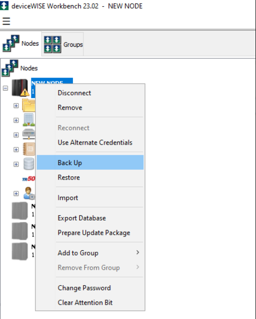

Right click on your Node name and select Back Up

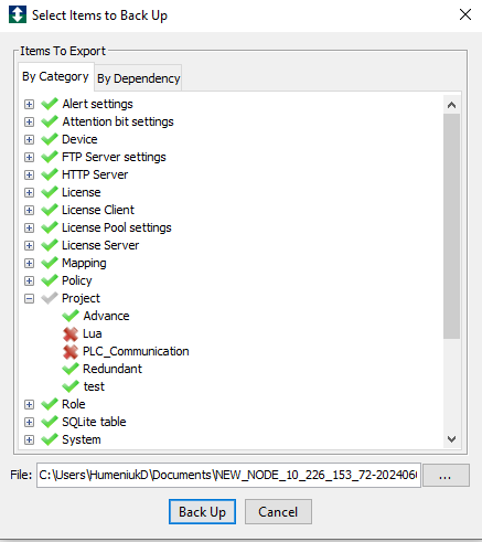

Select items you wand to save in back up package
Provide the location of back up file package

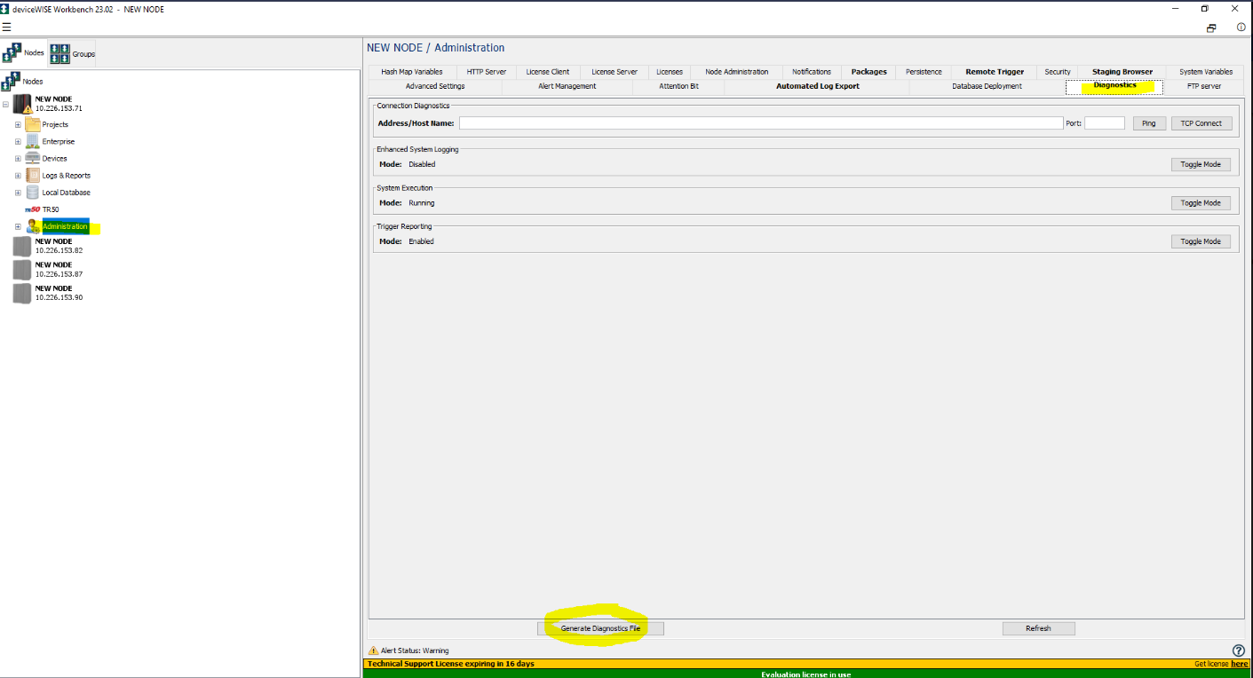

Go to Administration section, next to Diagnostic tab
Click Generate Diagnostic File

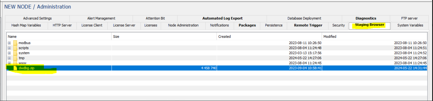

After the file is created it will be accesible in Staging Browser tab:
Download dwbdg.zip file
Having this file and backup file, we have created the complete copy of the current system
