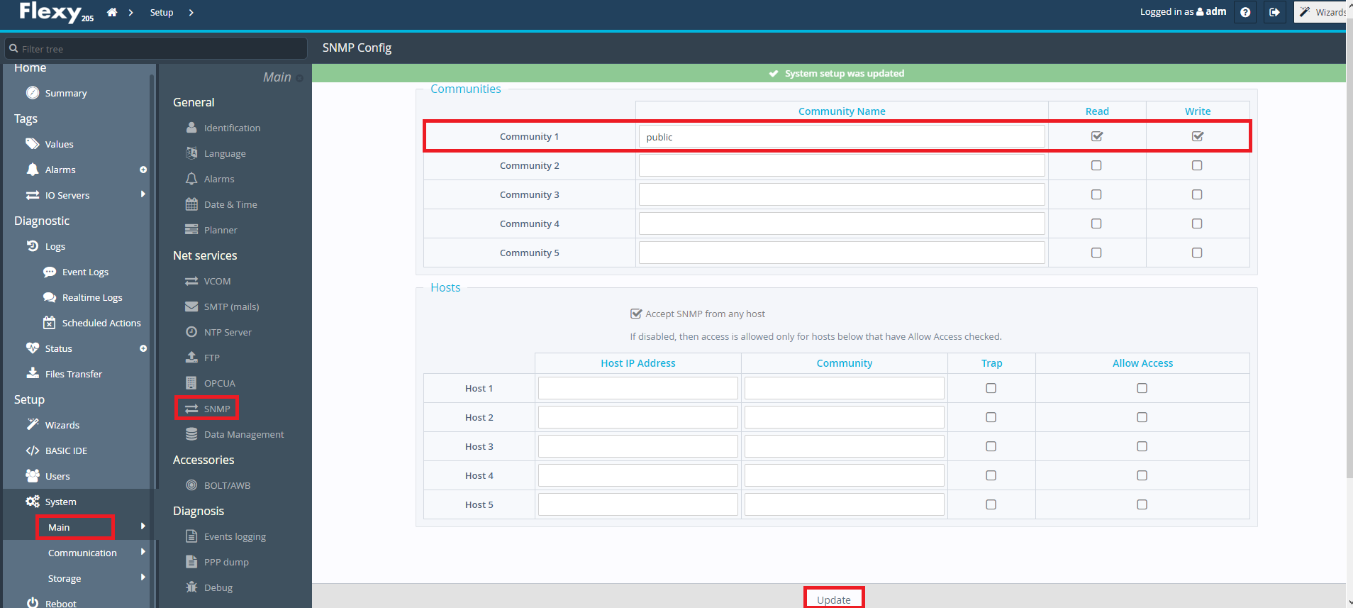

eWon configuration
Configure SNMP communication in eWon webserver - Setup - Main - SNMP
Fill Community settings and host IP that will be allowed to access eWon

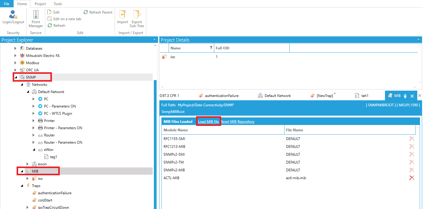

Iconics Configuration in Workbench
Load MIB file

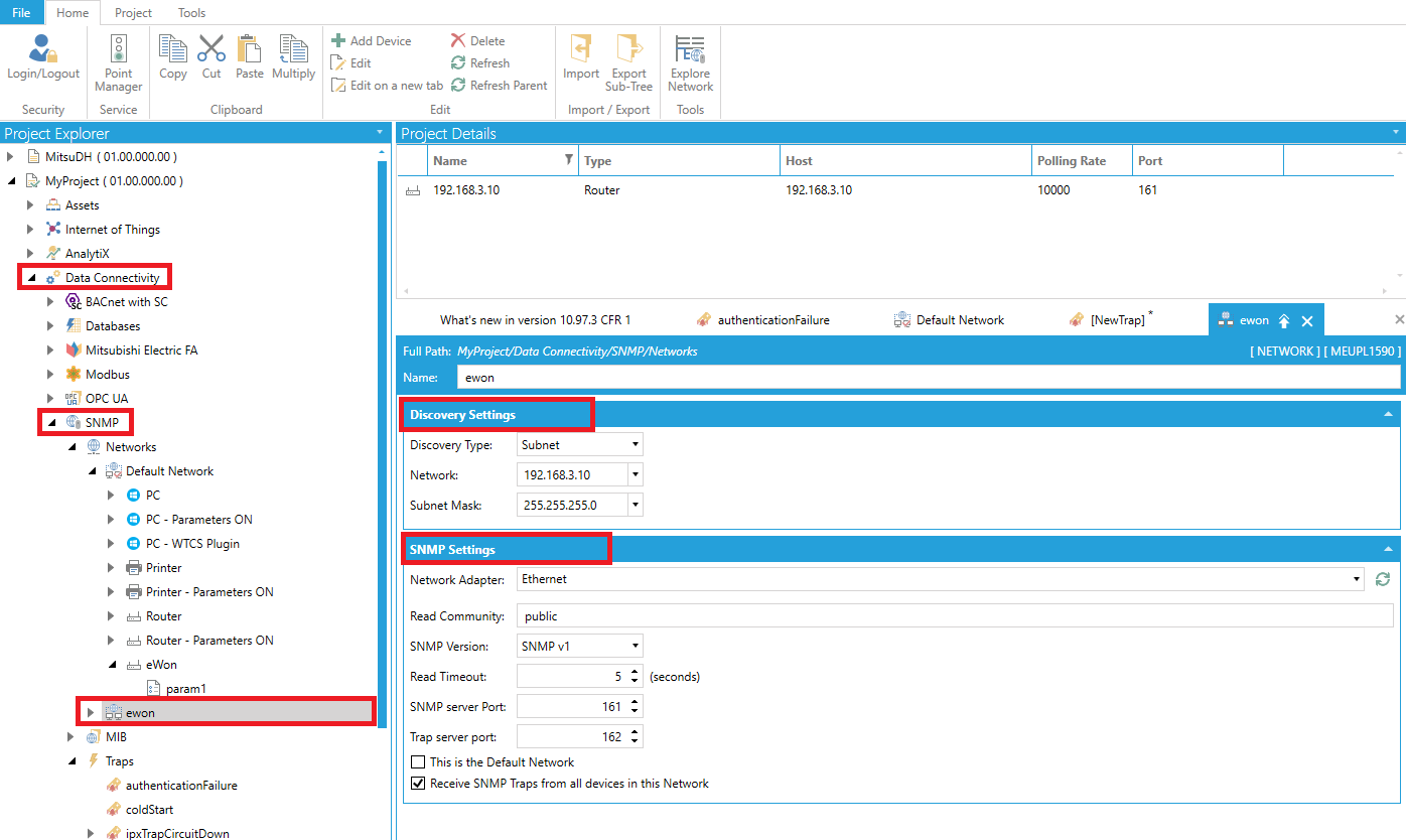

In Iconics add new Network in Data Connectivity - SNMP
In discovery setting
Network: eWon's IP address
In SNMP select SNMP version based on which version is supported by device. Ewon supports SLMP v1
Select the Community you want to connect to

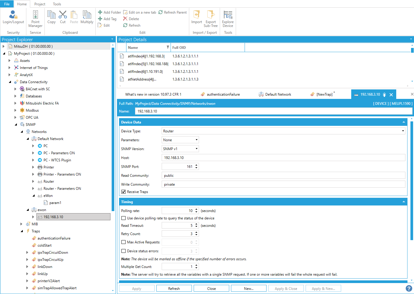

Then new device need to be added to the network

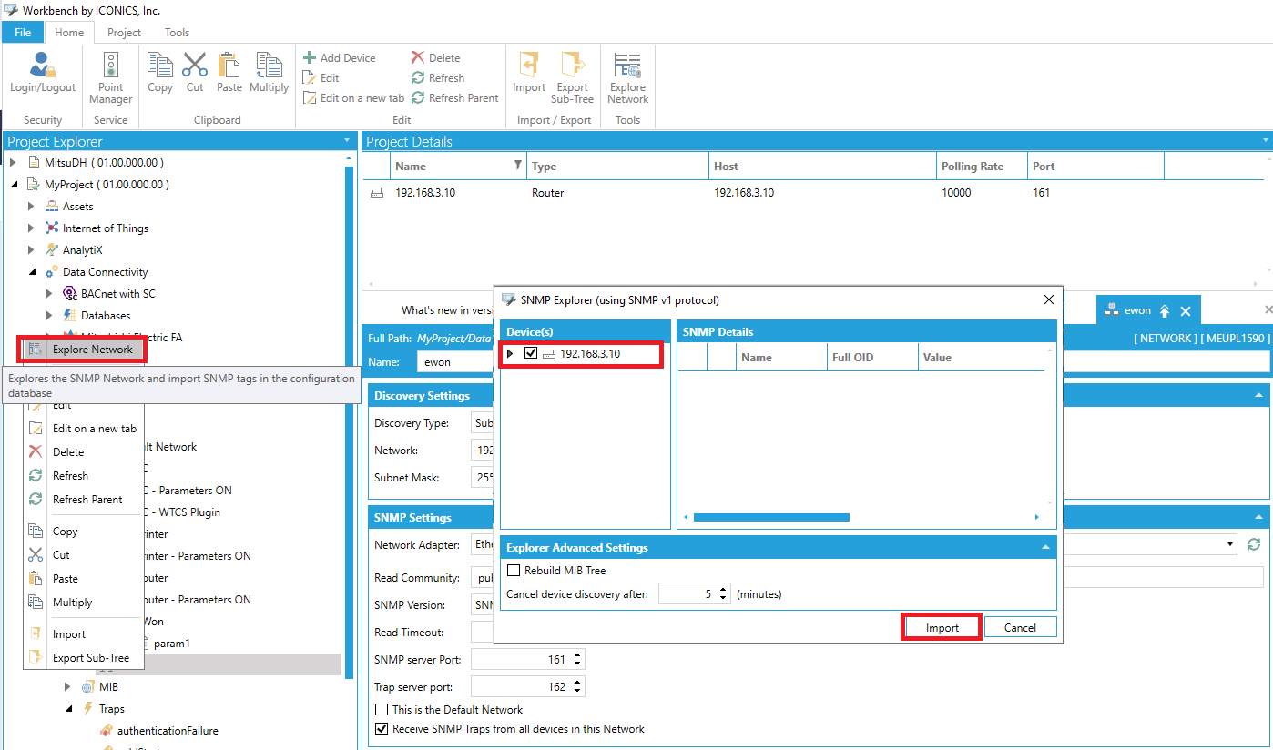

You can add the device manually - right click on network you have created and select Add Device
You can also Explore Network to detect available devices automatically
In device settings select device type you connect to, SLMP version, IP Address of device and port number (default port number for SLMP community reading is 161)

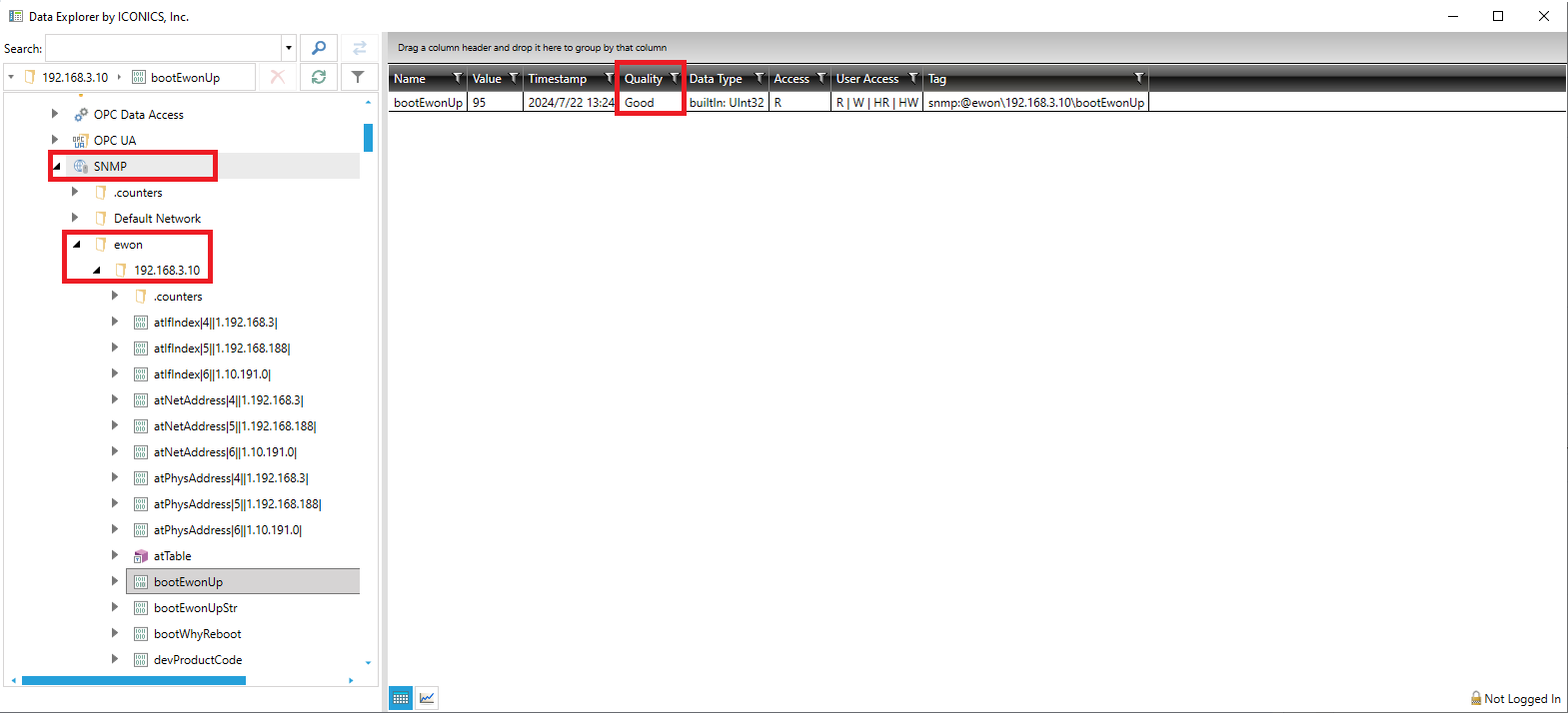

Check the connection
In data browser (for example in data explorer tool), check the quality of the connection
A list of accessible tags should be available
