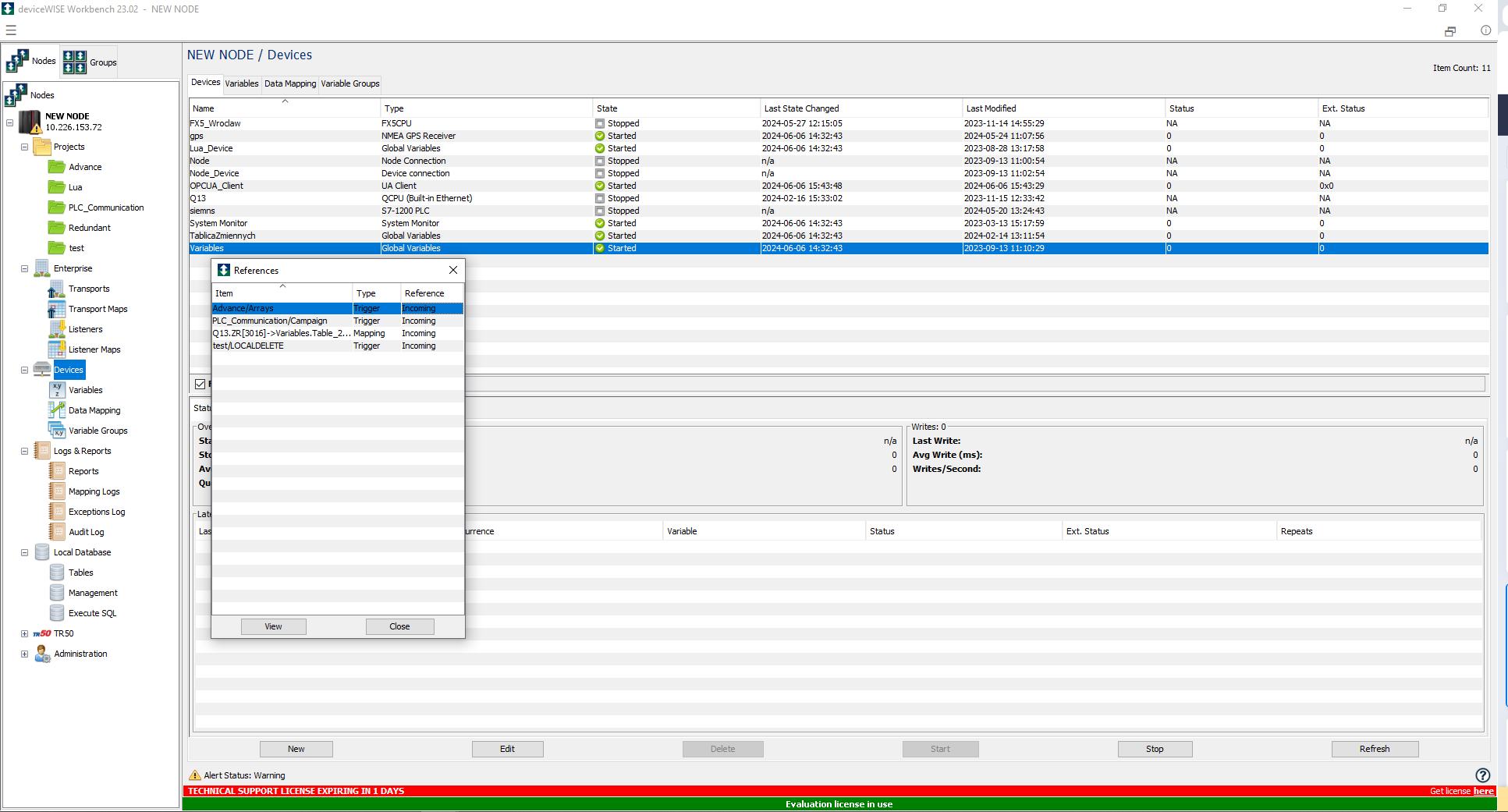

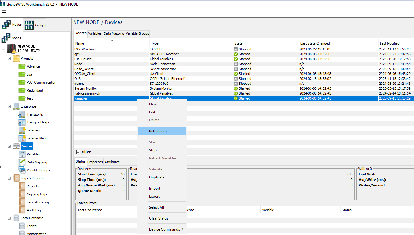

Where in project selected Device is used
Right click on Device you want to check
Click References:
You have references listed in References Window

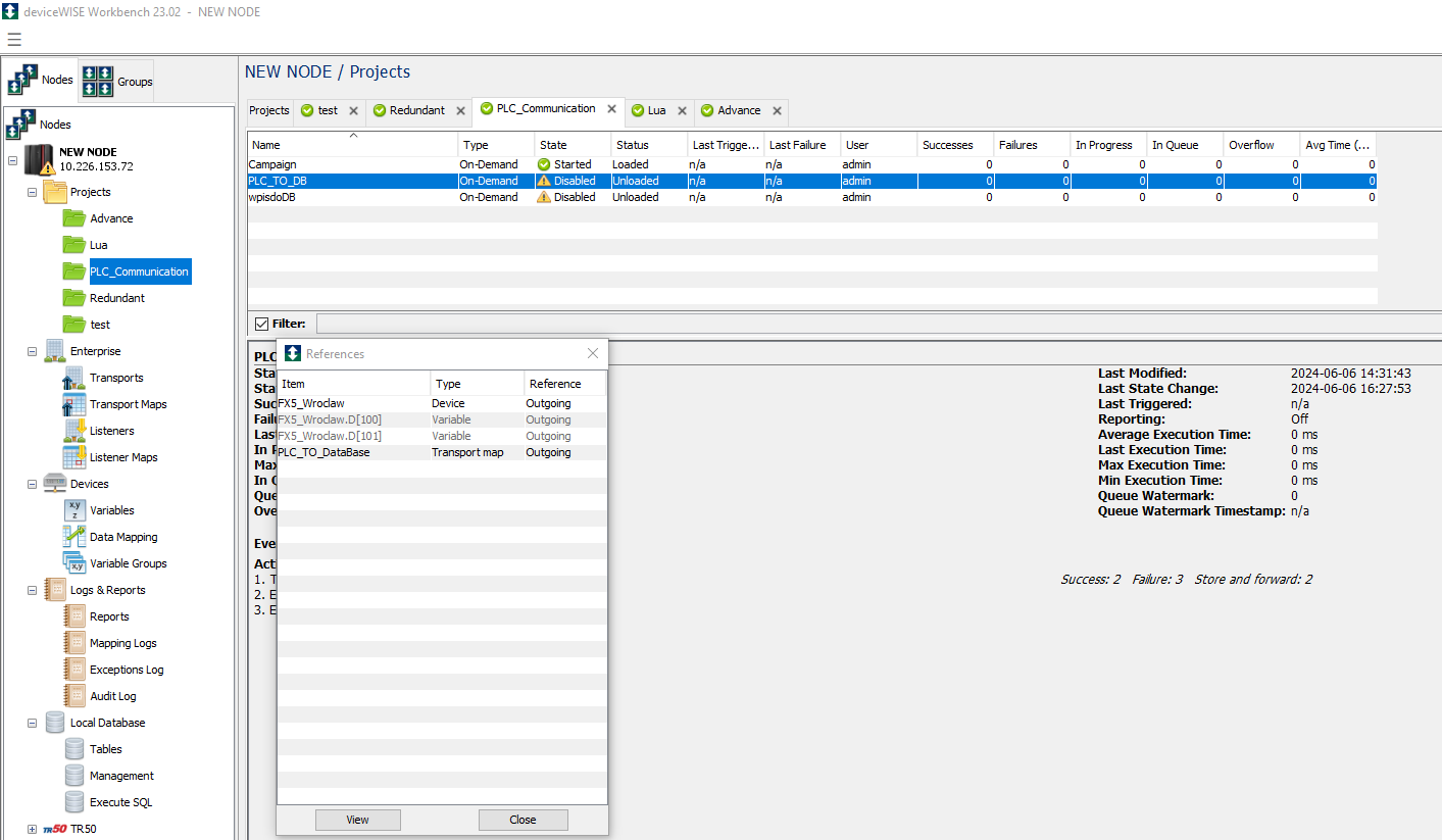

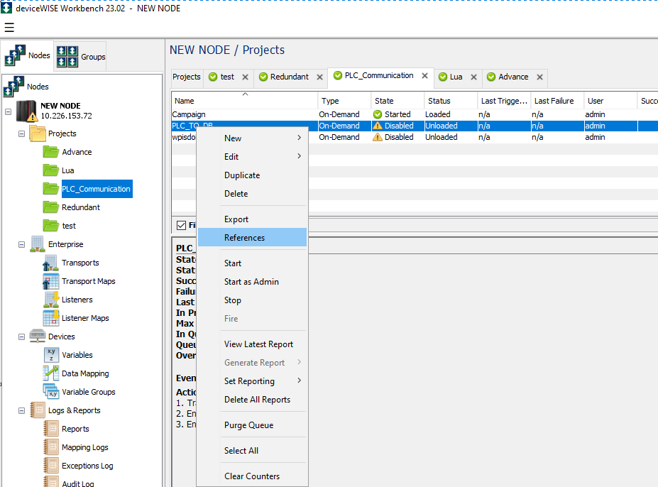

What variables and devices are used in selected trigger
Right click on Trigger name you want to check
Click References:
