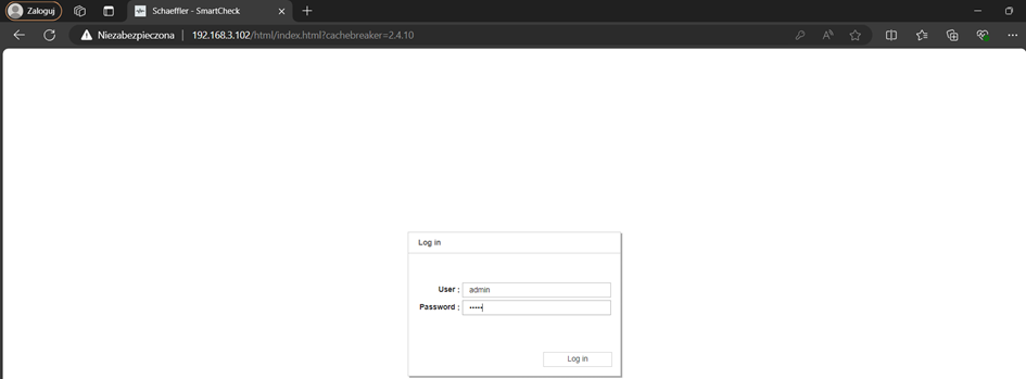

- Enter IP Address of Fag in browser and log in

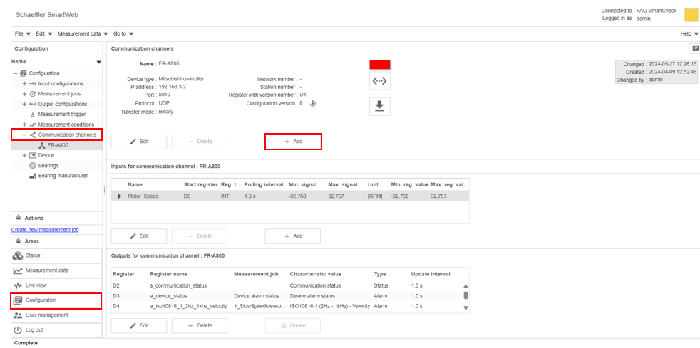

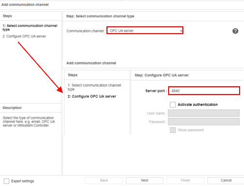

- Click "Configuration", expand "Communication channels" and click "Add" button to select OPC UA server as a communication channel like also number of server port.

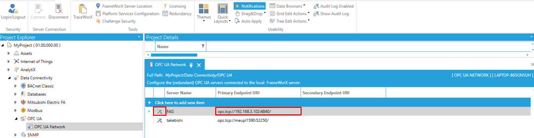

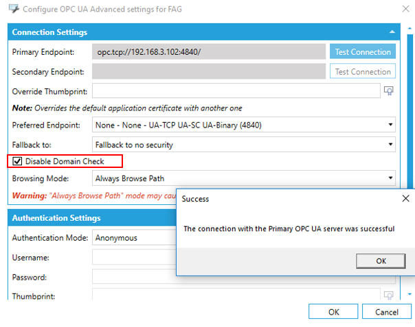

- Add new item in the OPC UA Network tab. As Primary Endpoint URI write FAG's IP Address and server point number after " : " mark; opc.tcp://192.168.3.102:4840/
- Check the connection by clicking the tools symbol
- Set the Connection Settings and Authentication Setting. After this you can click the "Test Connect" button
- It is very important to mark option "Disable Domain Check"; without it you could not the connection

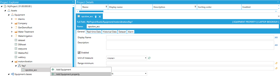

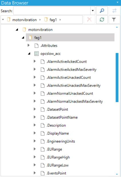

- Add new Equipment property in the equipment

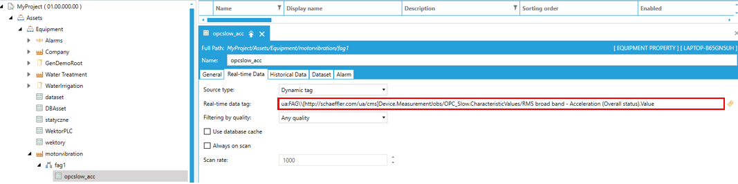

- In Real-Time Data tab insert Real Time Data Tag connected with FAG's variable
- Now, after this configuration, you can use any assets to control and manage selected machine parameters by using FAG and ICONICS connection.
