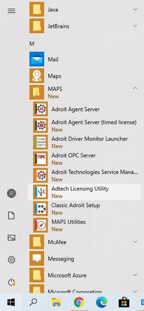

2. Launch the Adtech Licensing Utility under Adroit or MAPS folder in the Start Menu:

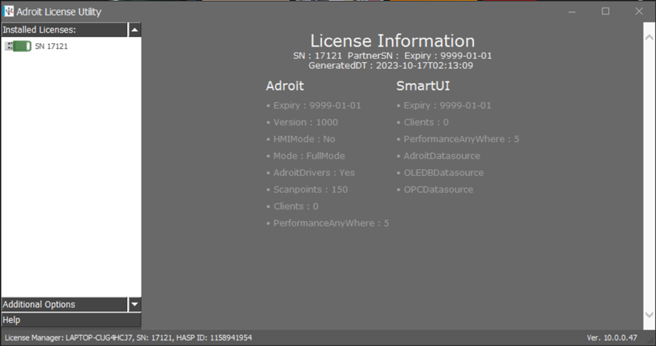

3. Make sure the HASP is detected by the Adtech Licensing Utility:

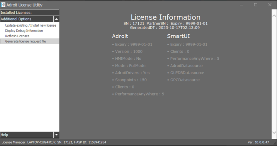

4. Navigate to Additional Options -> Generate license request file and click it:

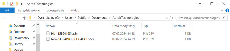

5. By default the HASP c2v request file will be saved to and can be found under the following path C:\Users\Public\Documents\AdroitTechnologies\ with the following filename: HL -[HASP ID of HASP] .c2v
