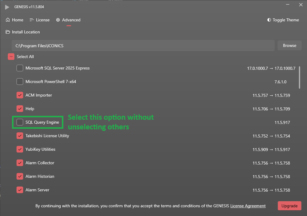

By default the SQL Query Engine is not included even in a full GENESIS installation. If you want to install it, make sure to switch to the Advanced tab of the installer and select it. If you are modifying an existing installation or performing an upgrade from an earlier version select it as well.
Warning
If you only want to add SQL Query Engine to your installation without touching other components, select the SQL Query Engine checkbox but don't unselect other components. When you modify the installation and unselect something, that component can be uninstalled in the process.
Proceed until you get a message about a successful installation. If your installation is unsuccessful check the logs for more information.

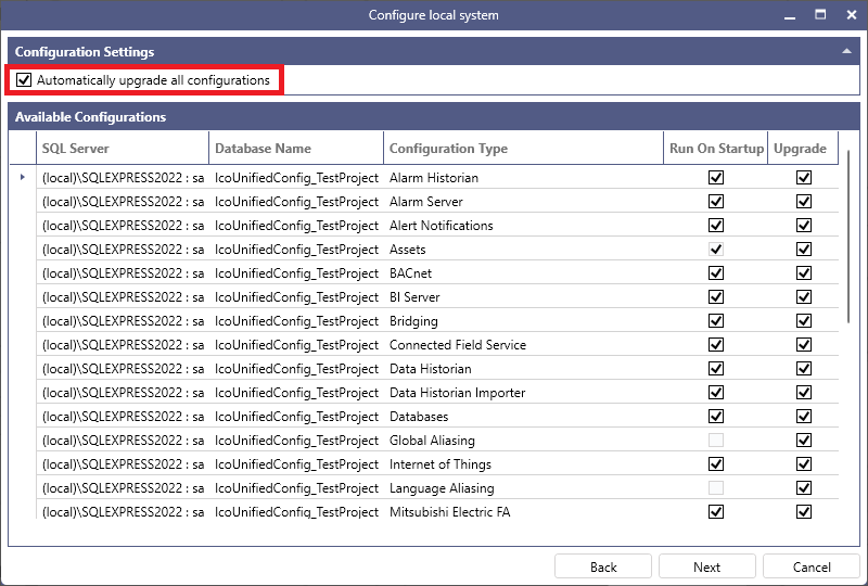

In the Configuration Settings step, make sure to select the Automatically upgrade all configurations option:
Complete the configuration for SQL Query Engine stored procedures to be added to your database.

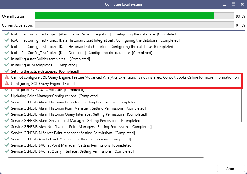

Alert
If you didn't perform a fresh GENESIS installation but added SQL Query Engine to an existing application, it is possible for the Configure System to return an error:

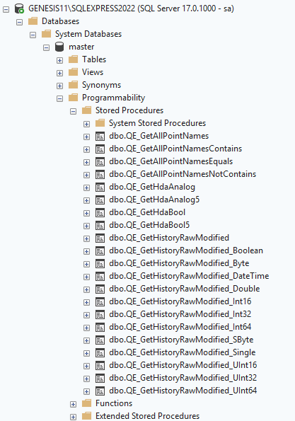

If the Configure System utility completed all the operations without errors, you should be able to find the SQL Query Engine stored procedures in the master database of your SQL Server:

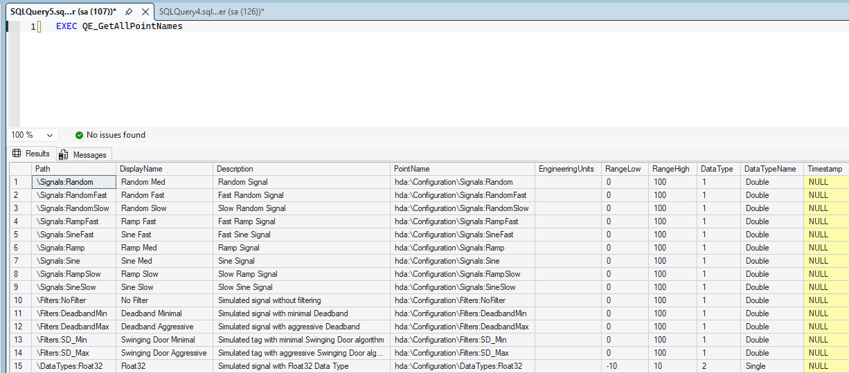

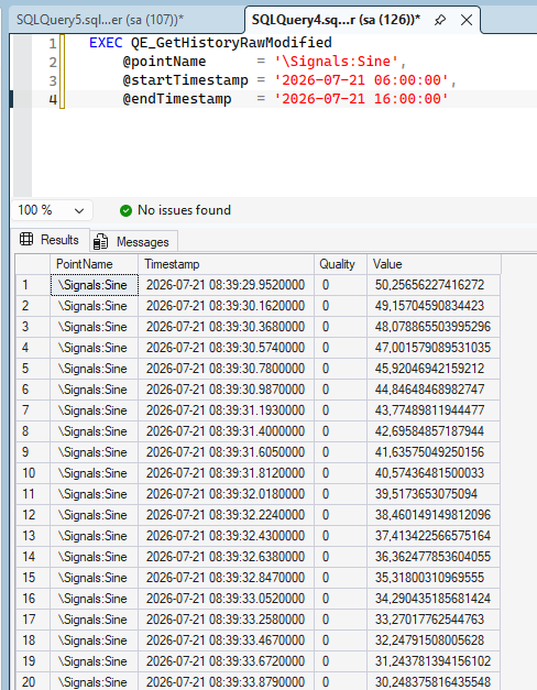

Use some basic queries to make sure you are able to read data. You can find query examples here: https://documentation.iconics.com/v11/Content/Data-Historian/SQL-Query-Engine/querying-historical-data-with-sql-query-engine.htm
