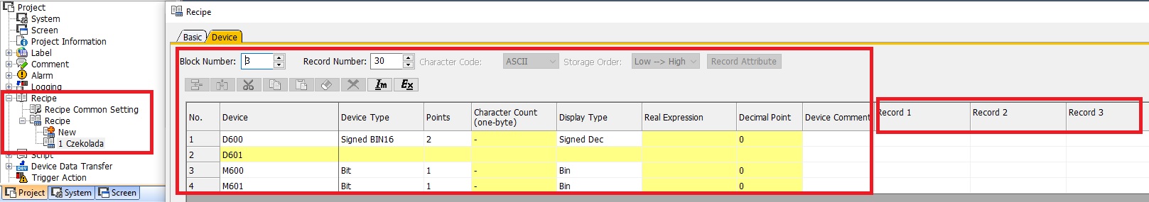

Reason 3
Changes made in already defined Recipe Definition
If Devices, Records or other esential elements were changed in existed Recipe Definition (picture below) then the previously made recipe files are incompatible and cannot be operated.

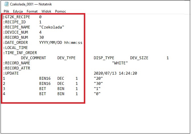

Recipe file’s information structure is made according to recipe definition:
Solution 3.1  (if changes are not needed)
Discard all changes in Recipe Definition. The old files will be working again.

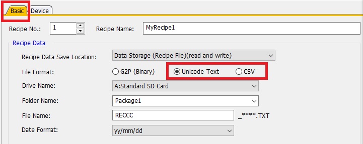

Solution 3.3  (if changes are needed, existing recipe files must be kept):
Open and correct recipe files to match them to the new settings made in Recipe Definition
This is possible only if they are in Unicode Text or CSV file format (see picture below)
