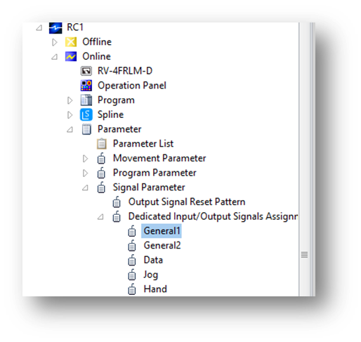

Using a Teaching Box or RT Toolbox3, check if Use the CPU buffer memory extended function bit in IQMEM parameter is enabled. If it is not, turn on bit 0 of the parameter to 1:

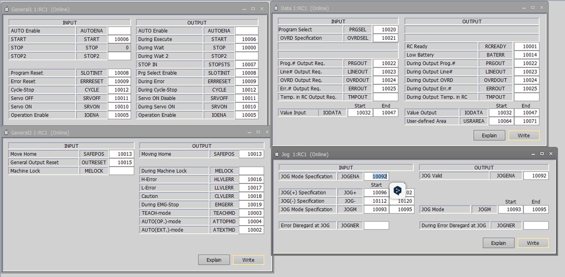

For robot data to be displayed correctly, set Dedicated Input/Output Signals parameters like below:
Alert
If you already use registers from outside the 10000+ range in your Dedicated I/O settings (for example when your robot is controlled over CC-link IE Field Basic or other network), add a program to your robot that rewrites the signals you use to registers shown above.
If you use the 10000+ range but arranged differently than above, you can either change your robot configuration or modify data addresses in Workbench after establishing the connection.

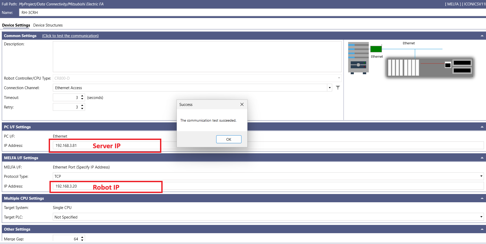

Set the name to easily identify the device, select CR800-D as the controller type and put in the IP addresses of your server's Ethernet port and of your robot controler. If your settings are correct and your robot is available on the network, you should receive a success message after clicking on Click to test the communication:
