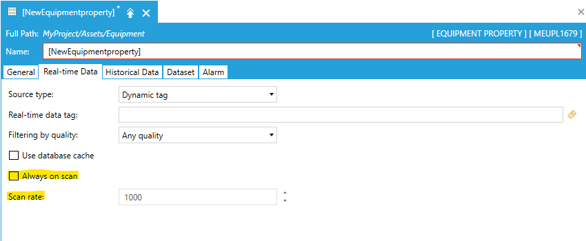

You can configure the Dynamic tag with option Always on scan.
If the Always on scan option is checked then the interval of communication should be as it's in the Scan Rate data input.

  1. Always On Scan -> ON
In this case the communication between OPC and Iconics will refresh data every time interval pointed in Scan Rate data input.
  1. Always On Scan -> OFF
In this case, the frequency of communication is imposed by the client. If it is GraphWorX, the screen has its own scan rate parameter in the properties, e.g. default 500ms, and this will be used. Additionally, if a given point is subscribed to by Hyper Historian, e.g. every 10 seconds, this communication will also take place.
