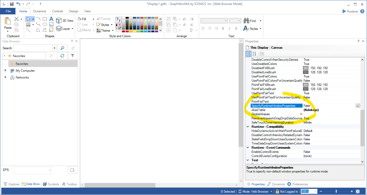

Change this properties to e.g. hide Ribbon, hide status bar, hide Title bar etc.
If you want to customize appearance of the displays shown in GraphWorX runtime you have to switch on Specify Runtime Window Properties:

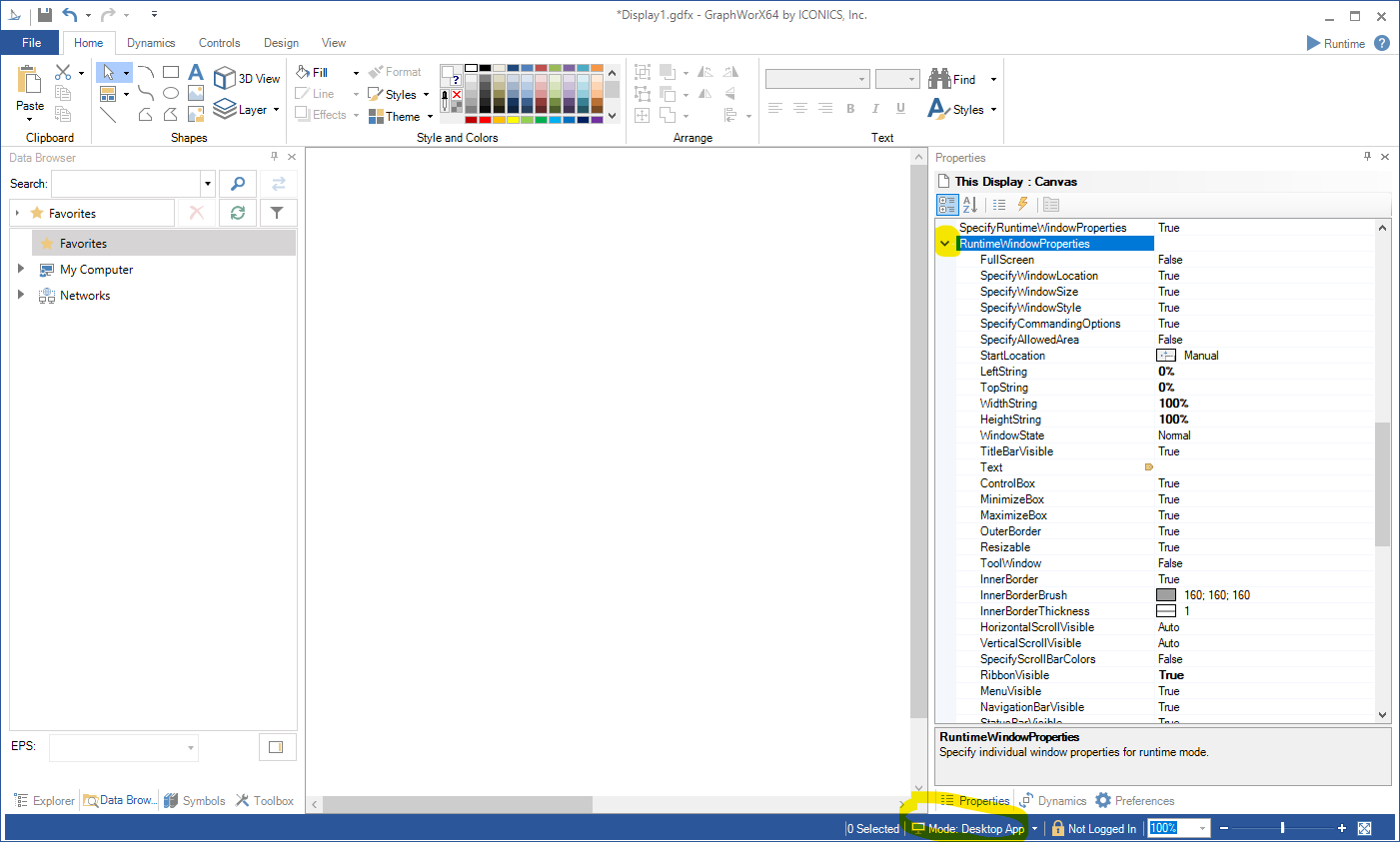

Then the runtime properties appears:
Now you can expand properties and customize runtime window appearance:
Remember to see all properties for desktop GraphWorX display you have to be in the Desktop App mode (bottom of the GraphWorX - on status bar)
