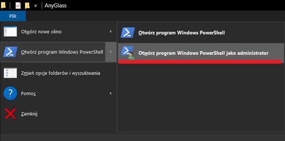

  4. Please run Windows Powershell as administrator (from Windows Explorer)
