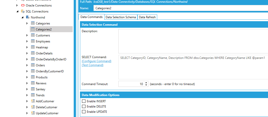

Keypoints of this solution

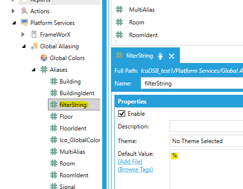

Global Alias
Please register Global Alias in Global Aliasing on backend to assing Default Value
Data Base DataSource

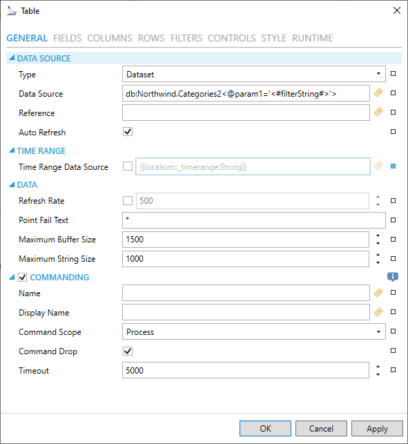

Table Control configuration

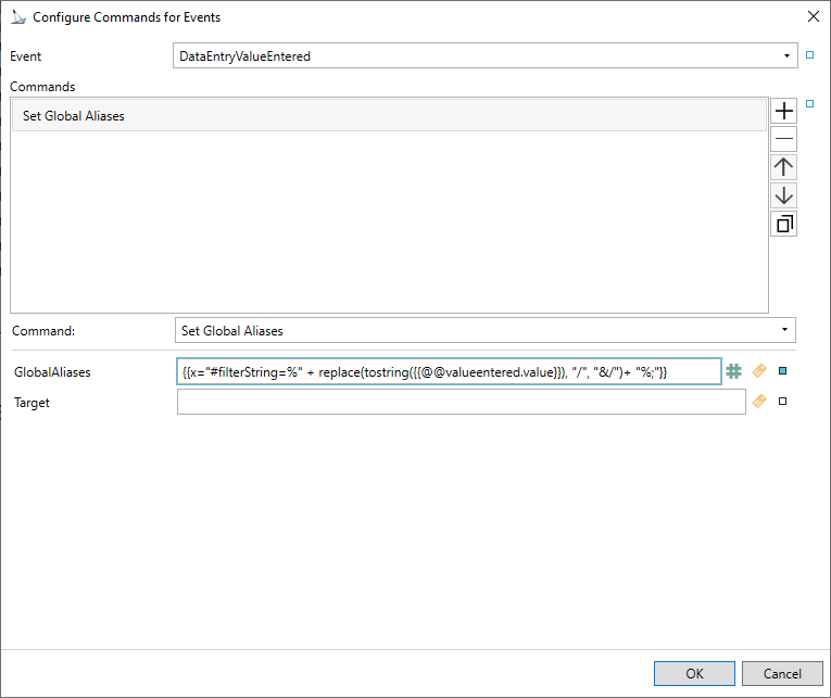

Data Entry event configuration
