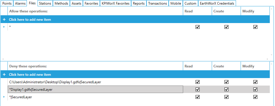

Workbench - Configure security to hide layers
Then, the last thing is to configure it in the Workbench security configurator.
For the user that you want to hide elements on created layer - head into the File tab and in the Deny these operations add something from the options listed here:
All these options above represent the same thing – you are allowed to use wildcards.
The first one disables the user/group to see the content under SecuredLayer in the exact Display1 on the desktop.
The second row disables them to see content under SecuredLayer in any GraphWorX display named Display1.gdfx.
The third option will deny access to content under SecuredLayer in any display which would contain layer with such name.
