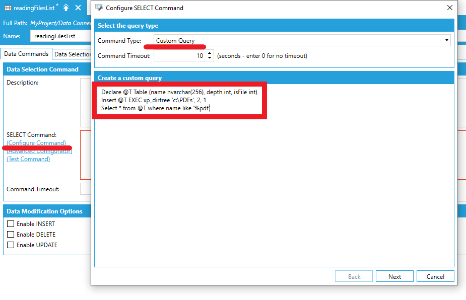

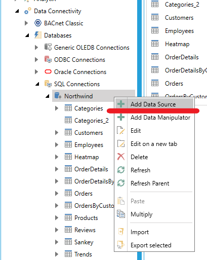

Using Workbench prepare Data Source under any SQL Server Native connection:
Prepare custom query (query as text highlighted below):
Declare @T Table (name nvarchar(256), depth int, isFile int)
Insert @T EXEC xp_dirtree 'c:\PDFs', 2, 1
Select * from @T where name like '%pdf'

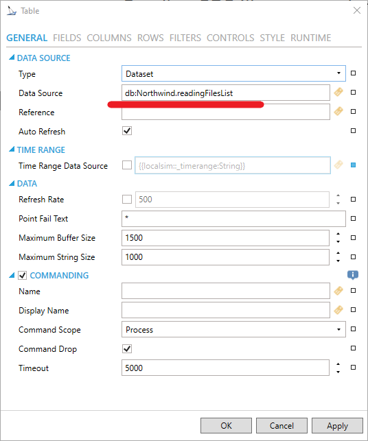

Table control configuration
Open Table control configuration popup and in General Tab change Data Source to just created custom query:

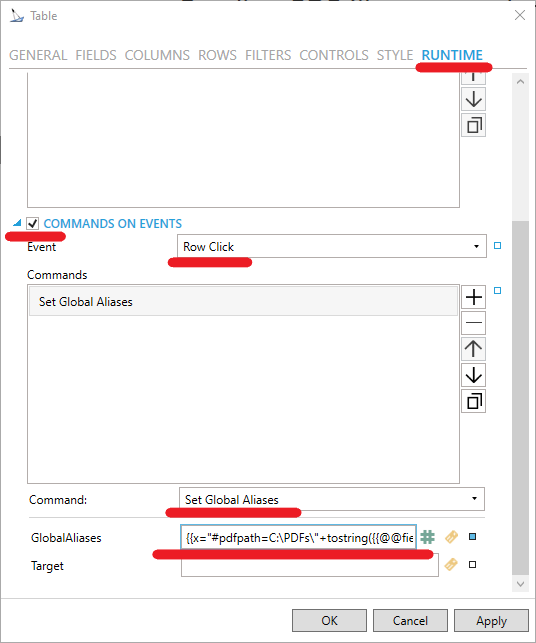

Now go to Runtime Tab and activate Commands on Events.
Next select Row Click event and pick command Set Global Aliases.
As global alias please use this sytax (just put in data input) :
{{x="#pdfpath=C:\PDFs\"+tostring({{@@field.name}})+";"}}
It should look like this:
Apply changes and close configuration popup.

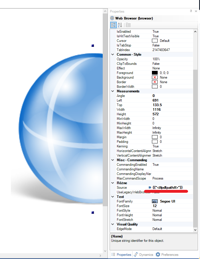

Click on web browser control and show its properties.
As a Source property put :
{{"<#pdfpath#>"}}

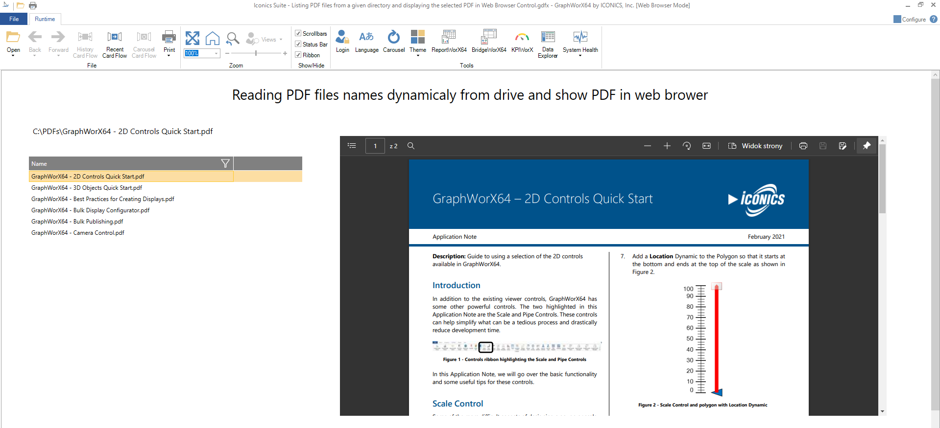

Now in the runtime when you click on the pdf file name in table it will load pdf file in web browser:
