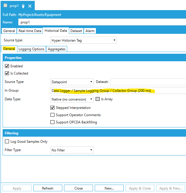

Pick logged tag. Open its asset property options.
Unprecise logging

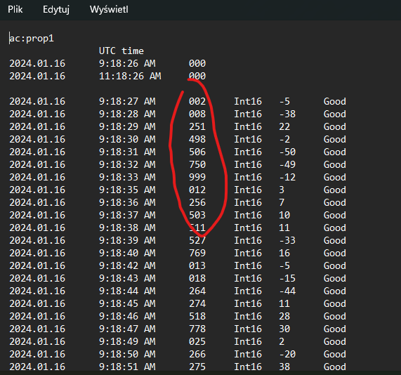

If we configure only standard options to logging every 1 second we will get unprecise timestamp with some milliseconds
Logging result with milliseconds

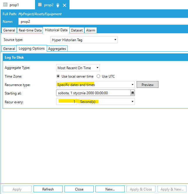

Change logging to more precise that 1 second
Switch to the Loggig Options tab.
Change Aggregate Type to Most Recent On Time
Pick Recur every: 1 second
Now we can see that the timestamp is at equal second without any milliseconds
The same result we could get with these options
