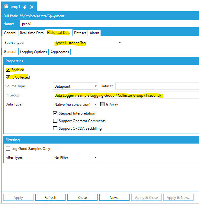

Create asset property and configure general logging properties of Hyper Historian tag.
Remember that the shorter logging interval gives you the more precise sample at exact time.

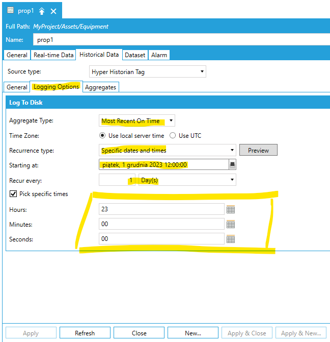

Switch to the Logging options tab.

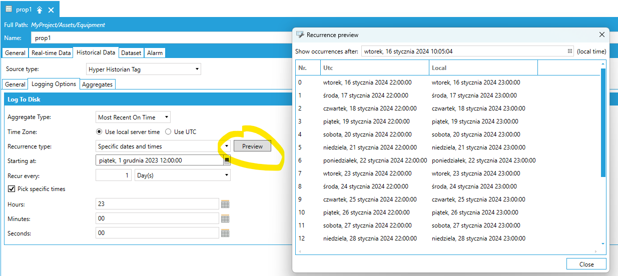

Select options as on the screen shot below.
The options will give you logging every day at 23:00
If you want to be sure how your options will impact on logging please use Preview button. The pop-up window with scheduled dates will appear.
