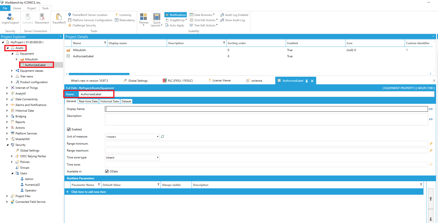

Create Equipment Property in Assets
In Asset Tree - Equipment, create any Equipment Property

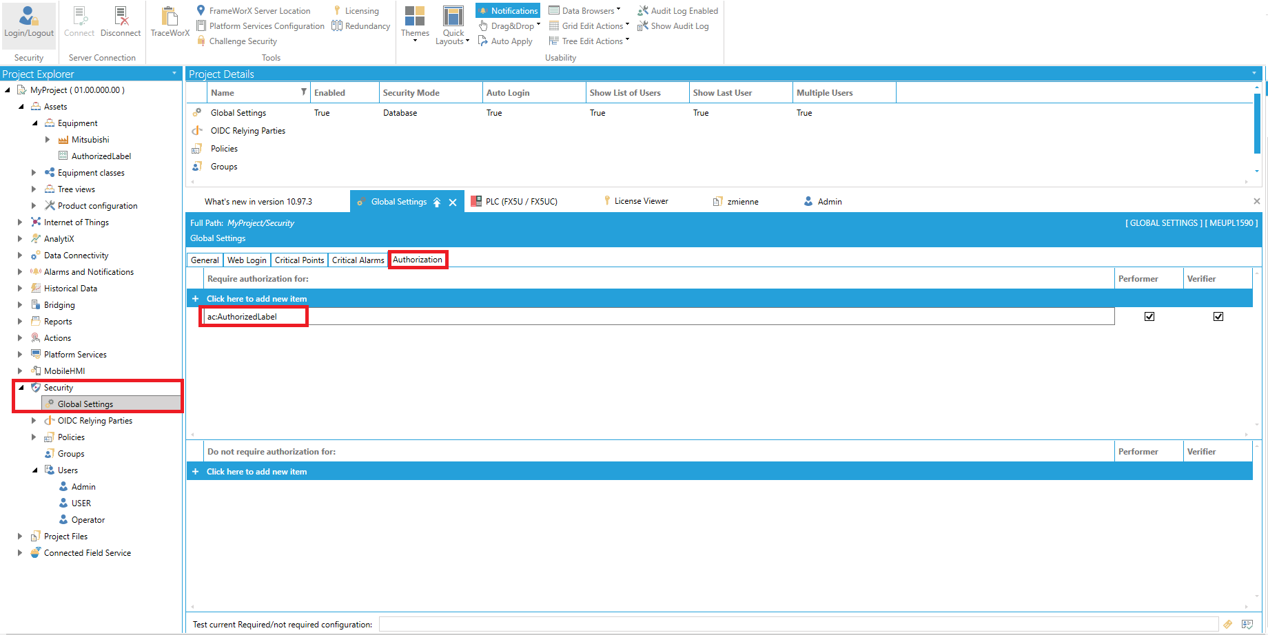

General Setting Security - providing Authorization for the Property
In Security - Global Setting go to Authorization tab and enter DataPoint name that require authorization
You can select if Performer or Provider is necessary to change this value

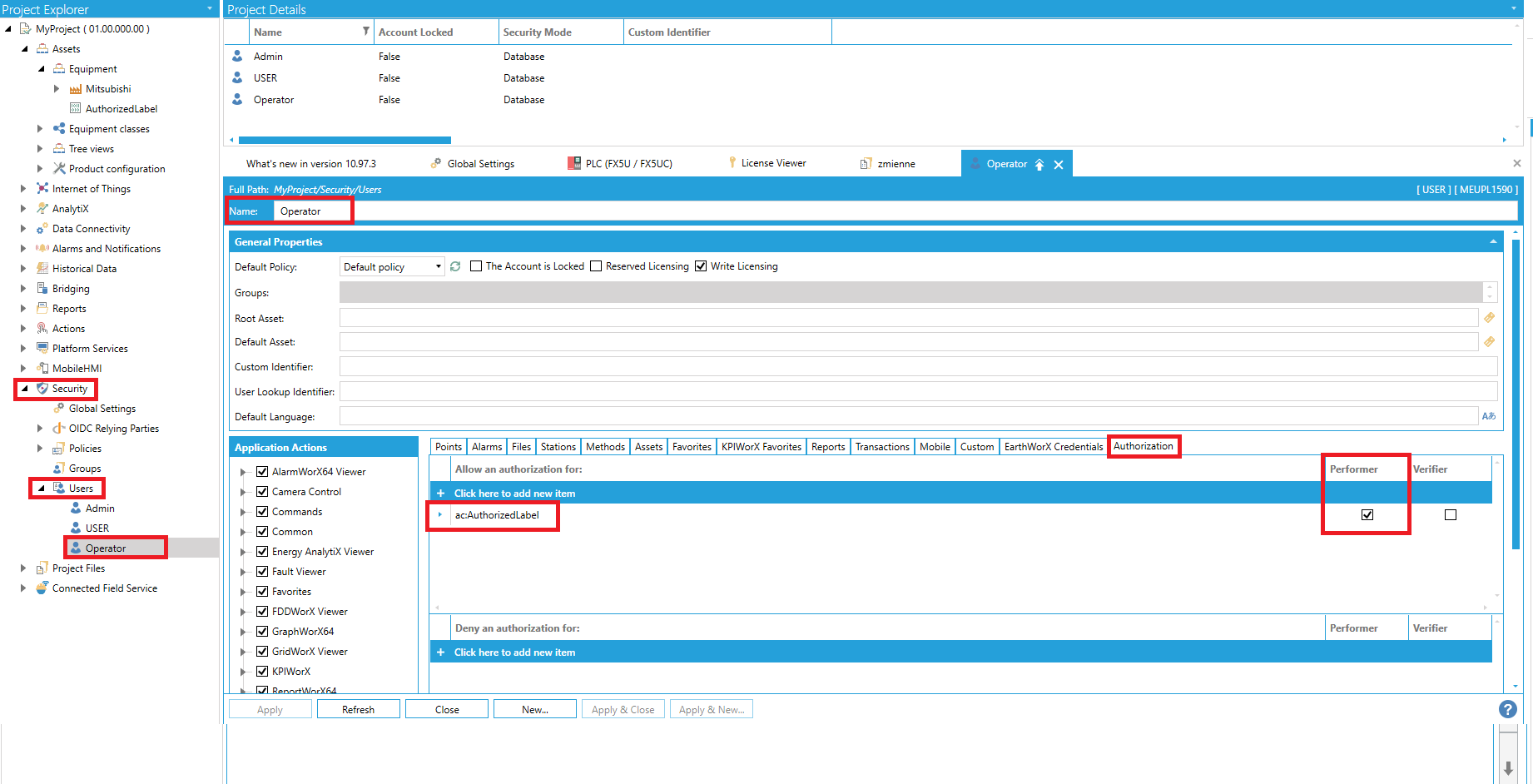

In Security - User, we create Operator Account. This user has proviliges to Perform changes on ac:AuthorizedLabel

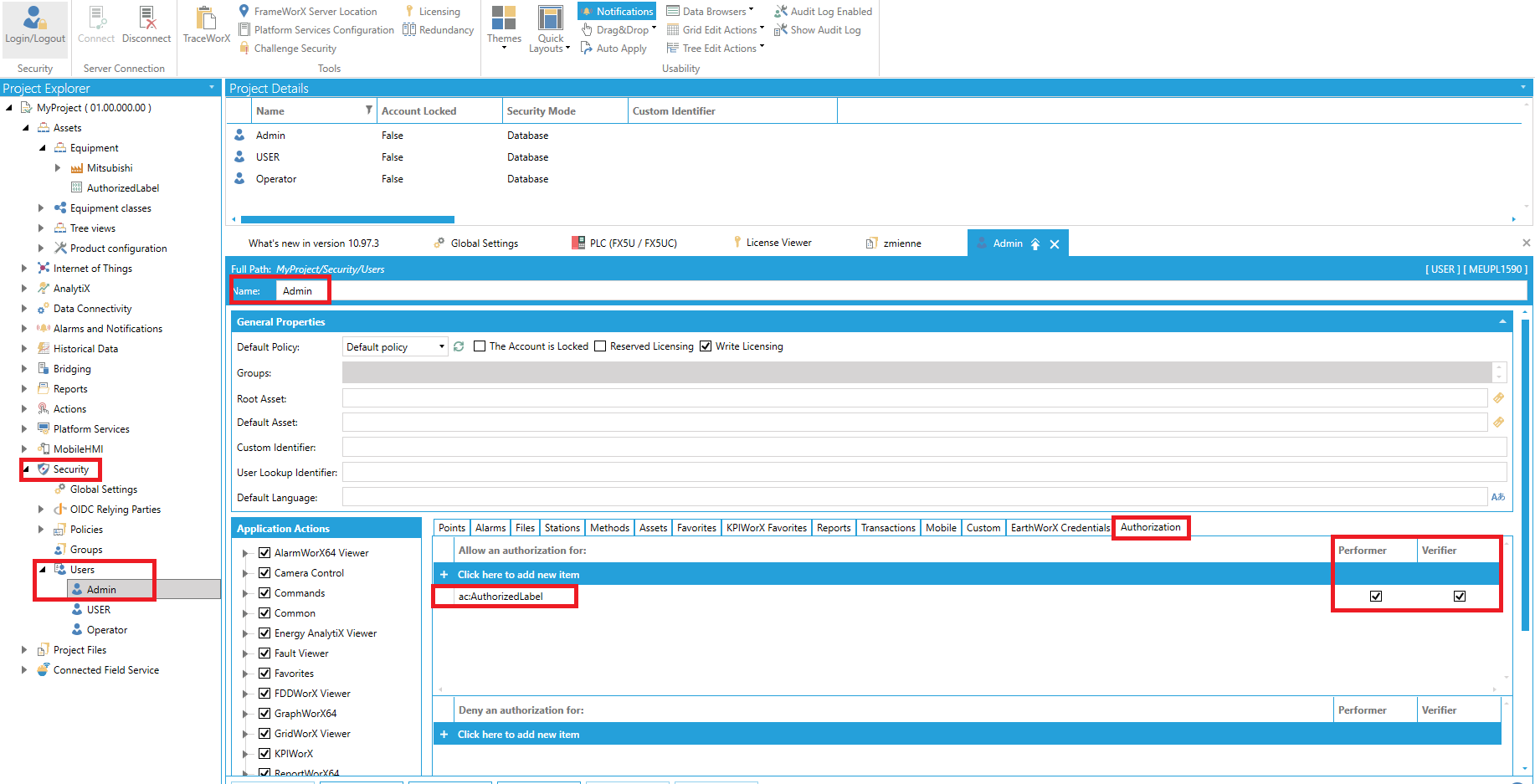

In Security - User, we create Admin Account. This user has proviliges to Perform and Verify changes on ac:AuthorizedLabel

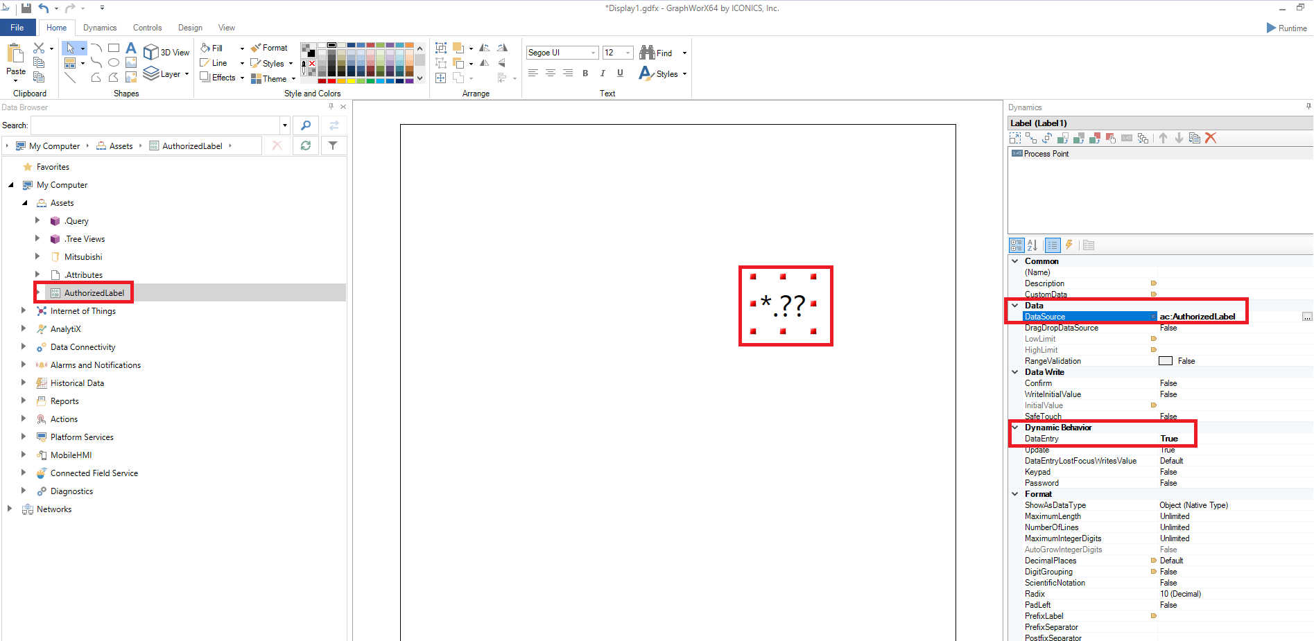

Create display with DataPoint that is configured as requiring authorization
Configure this process point to be Data Entry:

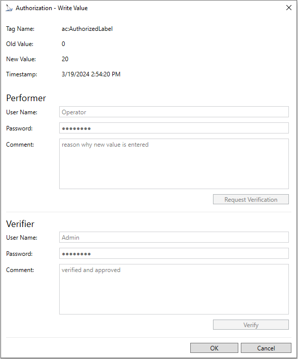

In runtime, when you try to change value of Process Point, you will see this form, that need to be filled:
If provileges are fine, click okey and new value is write info DataPoint

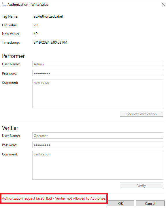

If we want to Verify operation by the user Operator it is not possible, because they only have acces to Perform Value change, not ot verify
You will see message like this in this case:
