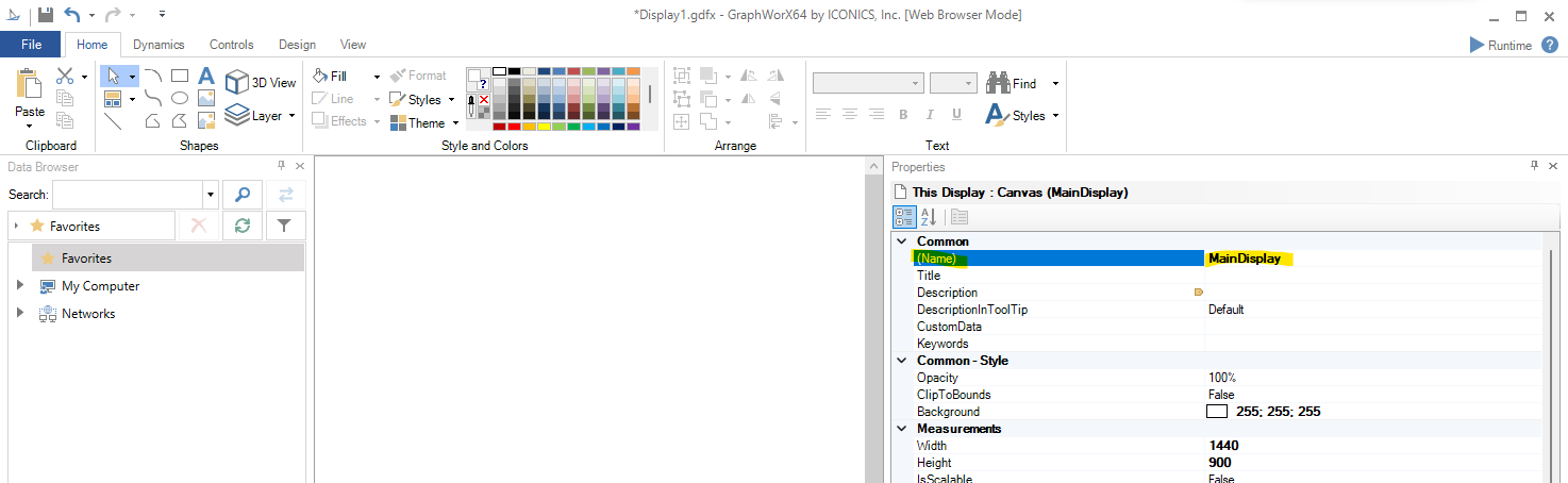

Open GraphWorX64 and create Display and add unique name to it.

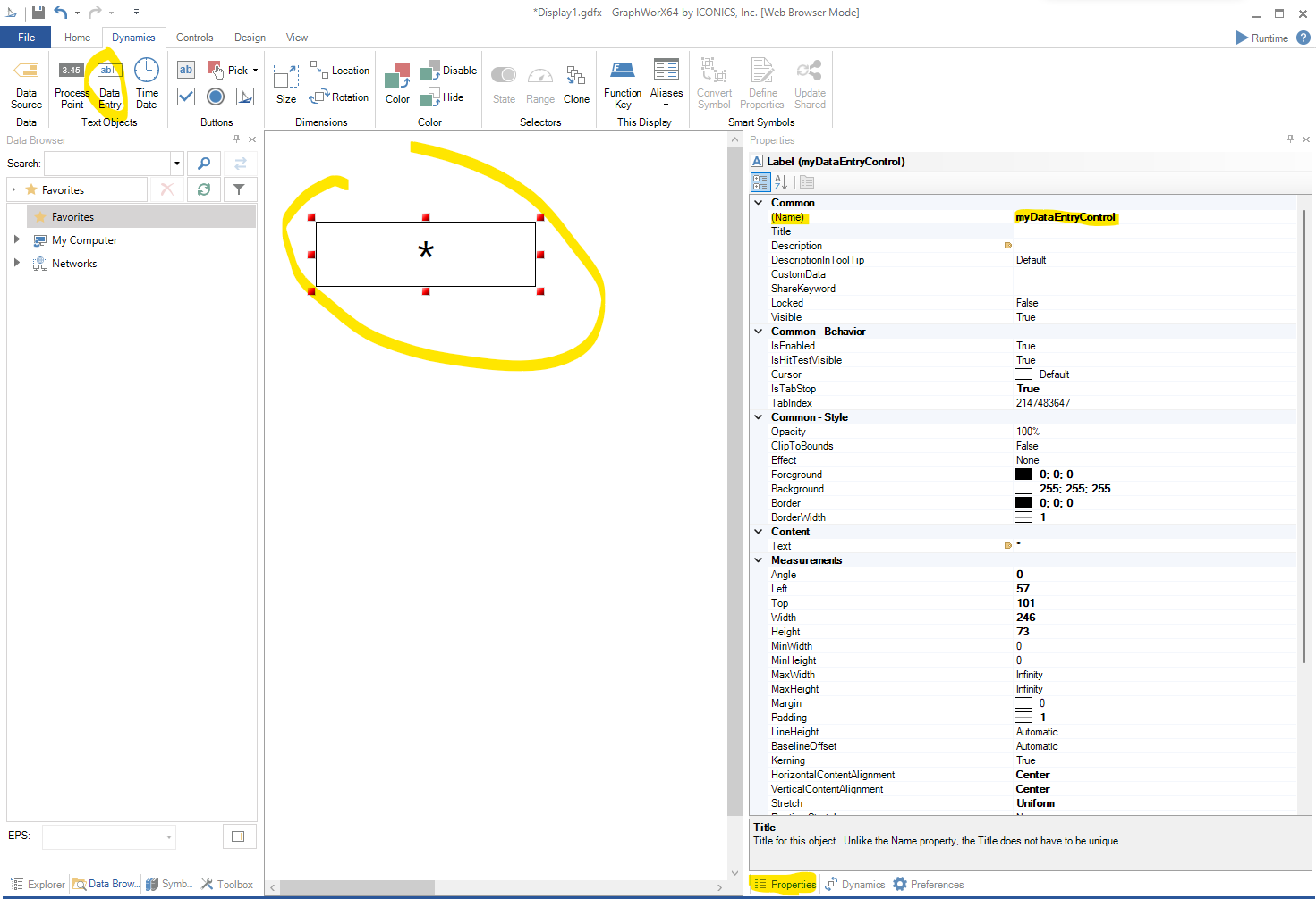

Put the Data Entry Control and add unique name to it. Keep in mind that you have to go to the properties of Data Entry Control and name the Label (see printscreen below)

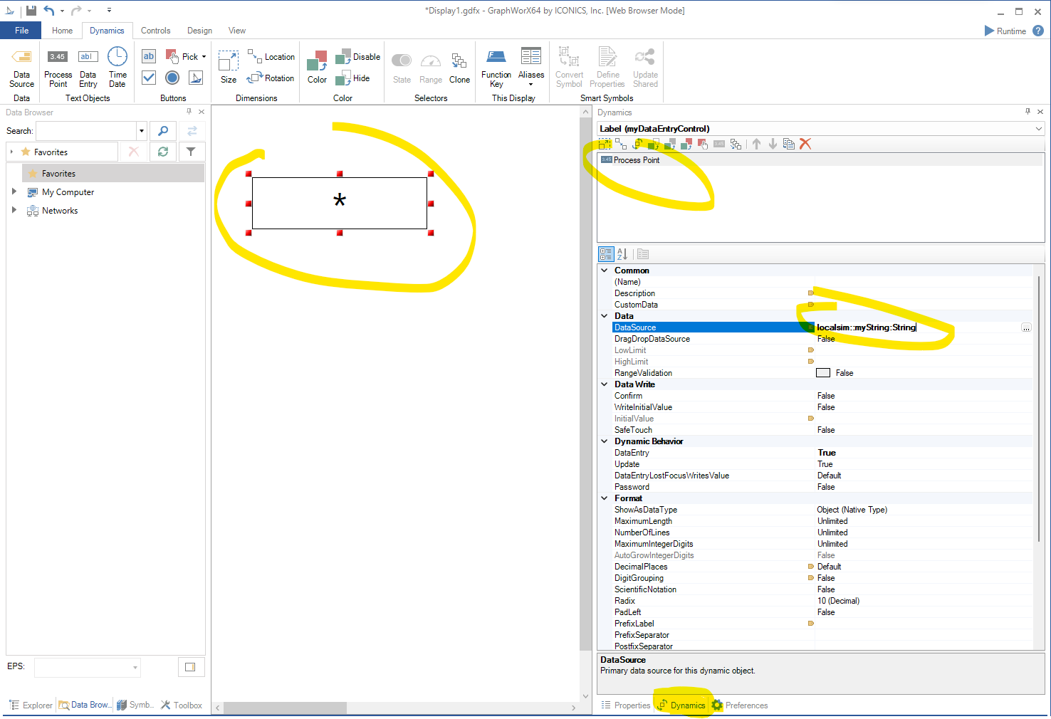

Go to the Data Entry control Dynamics and add any tag for the Data Source (e.g. localsim::myString:String)

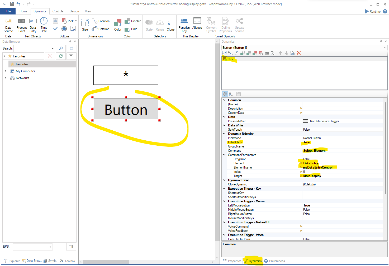

Now put the button on the display and configure it accorting to the print screen below.

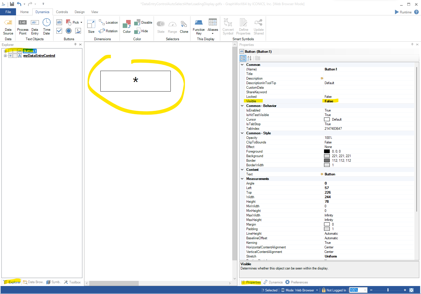

Test your configuration. If everything is working change button property : Visible -> false
If you want you can highlight you invisible button by pressing on it's name in the Explorer (right side menu) and move it somewhere to not collide with any other element during development stage.
