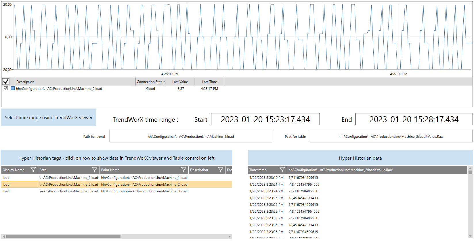

Sample display view
Sample description
This sample give you the possibility to view all samples of selected Hyper Historian tag in selected time range in GraphWorX viewer and in Table control.

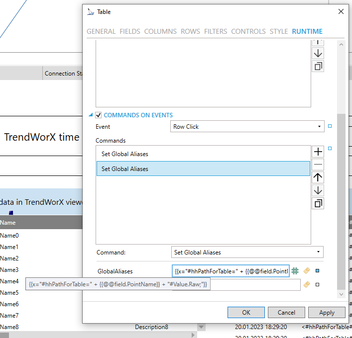

Using Hyper Historian tags list table (bottom left table) you can select HH tag to see its samples of logged data.
Using GraphWorX viewer you can select the time range of sample that you want to visualize.

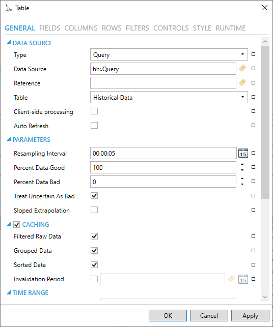

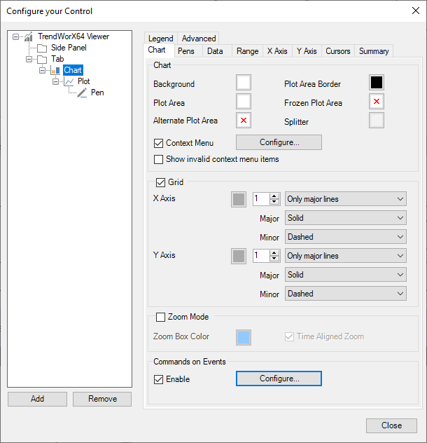

TrendWorX viewer

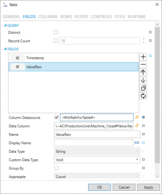

Historical data table
