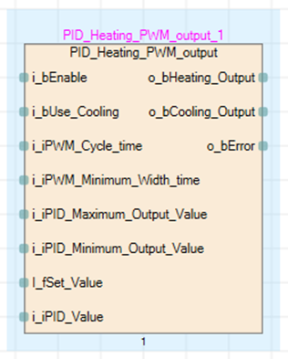

This function block for iQ-F PLC is used to control binary heating/cooling outputs using PWM when using PID regulator for temperature regulation but also can be used as standalone PWM controller.
      1.2 Inputs/outputs
Input/output
Data type
Description
i_iEnable
Bit
Enable signal
i_ibUse_Cooling
Bit
To use (TRUE) or not to use (FALSE) cooling output
i_iPWM_Cycle_time
Word (Signed)
Length of PWM cycle in miliseconds
i_iPWM_Minimum_Width_time
Word (Signed)
Minimum width time in one cycle in miliseconds
i_iPWM_Maximum_Output_Value
Word (Signed)
Maximum value of Manipulated Value (Mv) from PID
i_iPWM_Minimum_Output_Value
Word (Signed)
Minimum value of Manipulated Value (Mv) from PID
i_fSet_Value
Float
Set Value of temperature (Sv)
i_iPID_Value
Word (Signed)
Manipulated Value from PID (Mv)
o_bHeating_Output
Bit
Output for heating
o_bCooling_Output
Bit
Output for cooling
o_bError
Bit
Error signalization

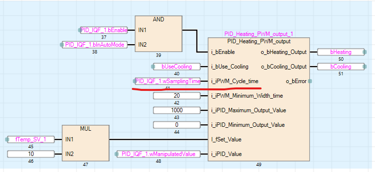

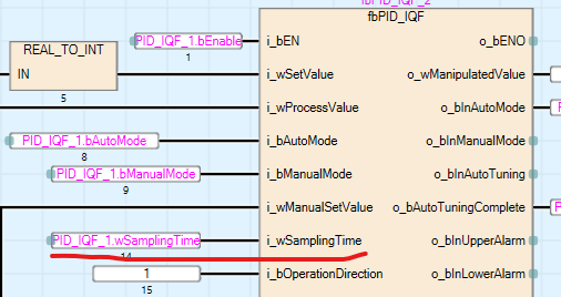

            3.1.1 Cycle time
PWM cycle time should be set with lifespan of relays in mind - 2s to 5s is a good value. Also PID Sampling time should be set to the same value.

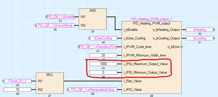

            3.1.3 PID output Manipulated Value range
This range should be set to be the same as Upper Limit Value and Lower Limit Value of PID

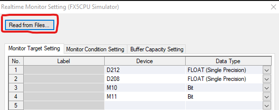

4. Monitoring
In attachment there is a  "log_viewer_monitor_settings" file for monitoring regulation in GX LogViewer for example project:
To open this file while starting log viewer you need to select:
