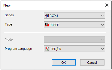

Creating new project
Startup GX Works3 and create new project. Select the model of the PLC CPU being used and a program language to be used in the PLC CPU on the window below. After completing the selection click the OK button.

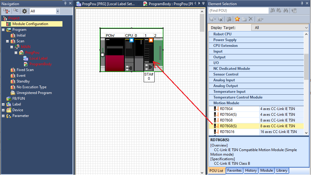

Open Module Configuration from the project tree. Create configuration of your PLC by dragging and dropping modules form Element Selection window.
To use Motion Module in Simple Motion mode you have to place module with ending (S). Only 4, 8 or 16 axis module can be use in Simple Motion mode.
It is possible to read module configuration form PLC by menu Online >> Read Module Configuration from PLC. In this case make sure that RD78G module is in Simple Motion mode. If it's in standard mode you have to replace it to those with ending (S).

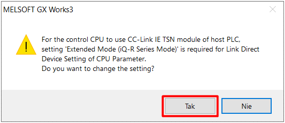

When configuration is ready Fix Parameters for example by closing Module Configuration window.
In the popup bellow that will appear you have to click Yes.

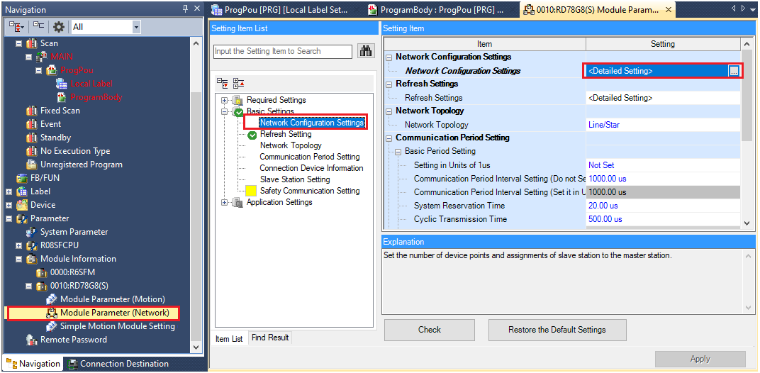

Network configuration.

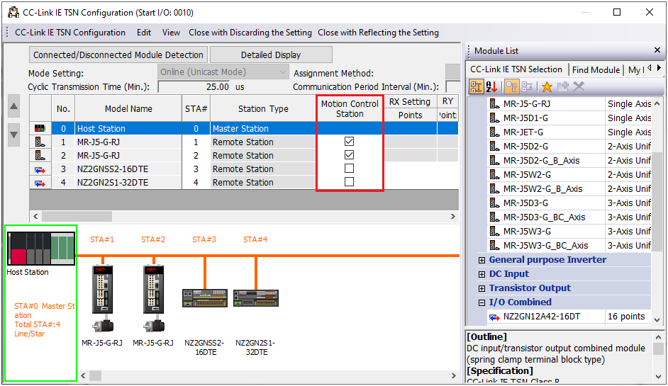

To create network configuration go to Module Parameters (Network) >> Network Configuration Settings >> Detailed Setting.
In CC-Link IE TSN Configuration window create configuration by adding devices from Module List to the network configuration. Each device is identified by the IP Address. Network part (first three octets) of IP address is determined by the IP Address of master module, last octet needs to be set by switches on slave module (amplifiers and remote IOs). In column Motion Control Station check stations (servo axes) that will be used as a Axes in Simple Motion. The rest of devices will be used as standard network device. It is necessary to assign them RX, RY, RWr and RWw base on specification of those devices.
When configuration is ready close this window with saving the settings.

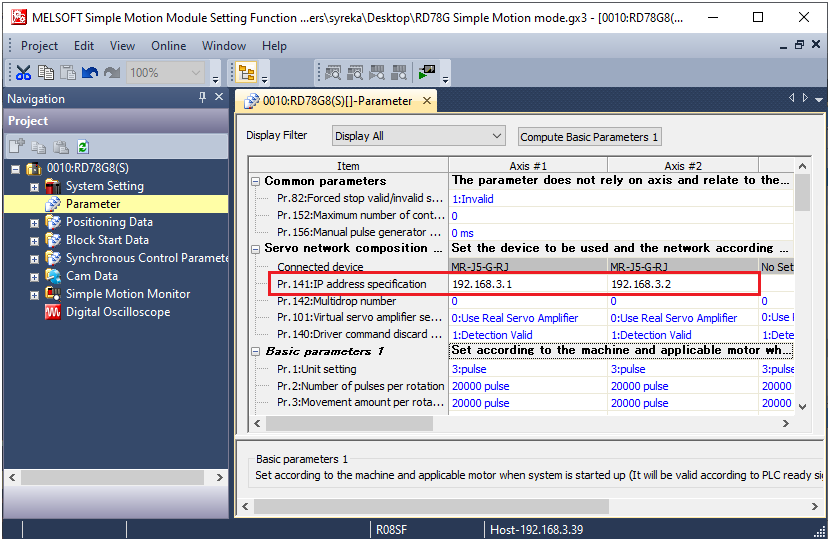

Axes definition
It's necessary to define axes in Simple Motion module and assign servo drives as a network devices to the appropriate axis. To define axes go to Simple Motion Module Settings of RD78G module. In Simple Motion Module Setting Function assign IP Addresses of the servo amplifiers to the axes in parametr Pr.141.
When configuration described above is finished convert project in GX Works3 and download it to PLC.

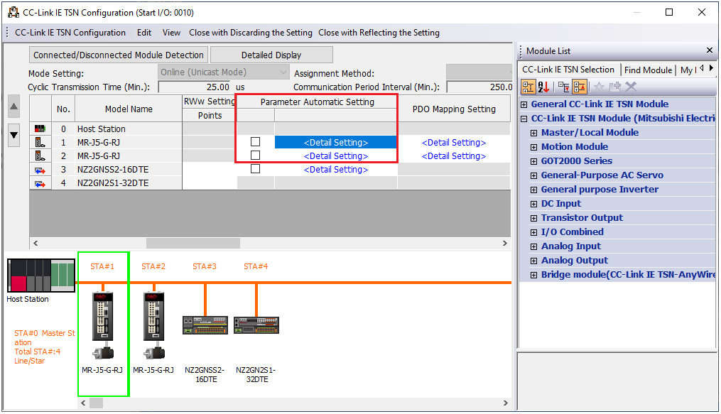

Setting parameters through GX Works3
Go to the Module parameters (Network) of RD78G module and open Network Configuration Setting. In CC-Link IE TSN Configuration window go to Parameter Automatic Setting column and double click Detail Setting for one of axes. MR Configurator2 will open.  Settings done in MR Configurator2 can be written to the amplifiers directly or you can close MR Configurator2 with saving settings, then check tick in Parameter Automatic Setting column. It will cause that servo parameters will be written to the amplifier automatically during system startup.

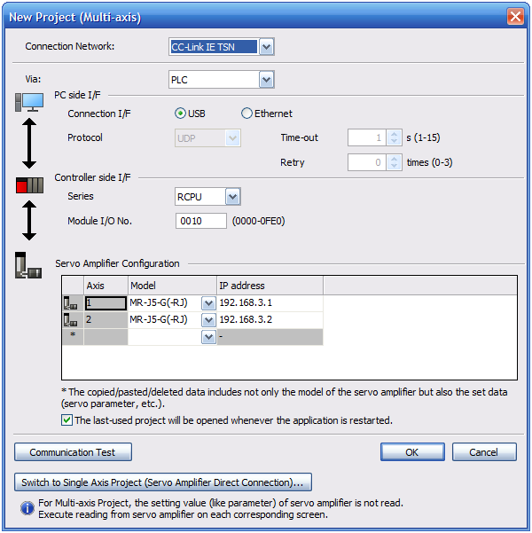

Setting parameter directly through MR Configurator2
Open MR Configurator2 and create new project. Switch to Multi-axis project and define connection with amplifiers. It is possible to communicate directly with amplifiers through CC-Link IE TSN or communicate through PLC using USB or Ethernet connection.
