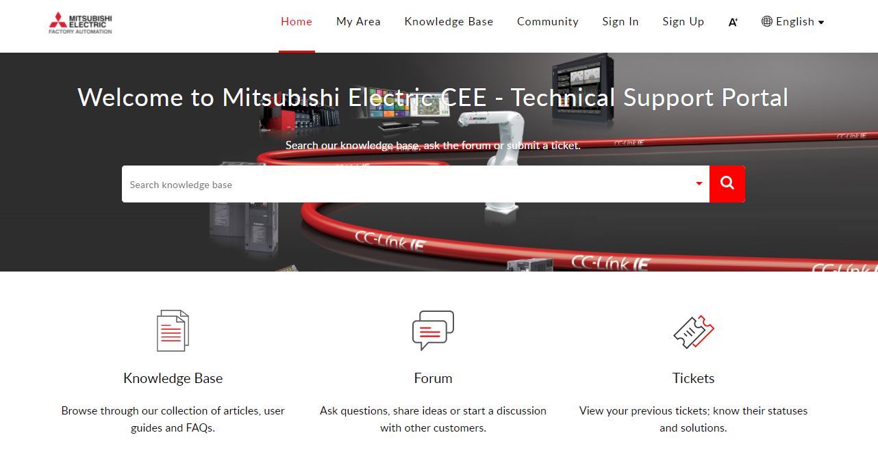

Knowledge Base - FASupportME
https://www.fasupportme.com/portal/en/home
This webpage gives you access to a knowledge base with solutions to common problems, device startups and a description of functionality.
There is also a forum that provides useful practical knowledge and the option to contact Mitsubishi Electric local support. Webpage is avaliable in manya local languages from CEE region.
Forum and knowledge base in partly open for all users. For access to all information SignUp in necessary.
