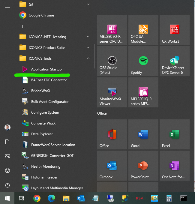

Application Startup
- run the Application Startup

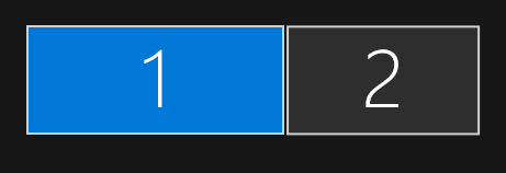

Monitors resolutions and layout
- phisically our configuration contains 2 monitors. First one have resolution 2560x1080 and second 1920x1080.

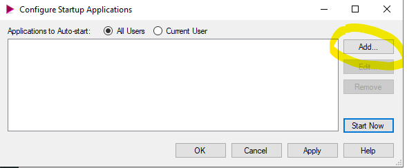

Application Startup configuration
- add 2 configurations of startup screens

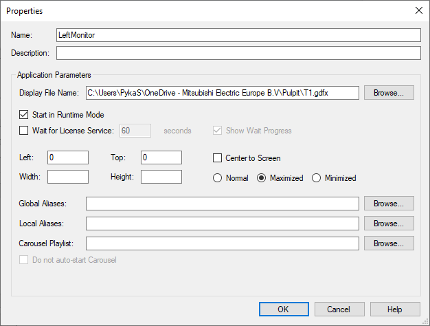

First monitor configuration

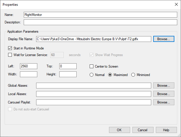

Second monitor configuration
